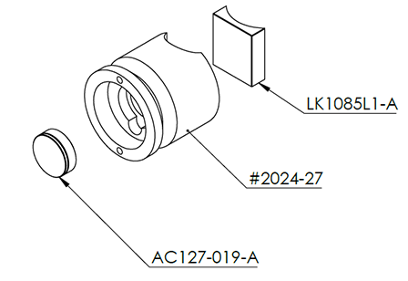

Step 1: Assemble the optical barrel
Glue the AC127-019-A achromat lens and the LK1085L1-A cylindrical lens into the barrel element using epoxy glue. Pay attention that both of the lenses are well inserted and flat in place as any misalignement will impact light collection.

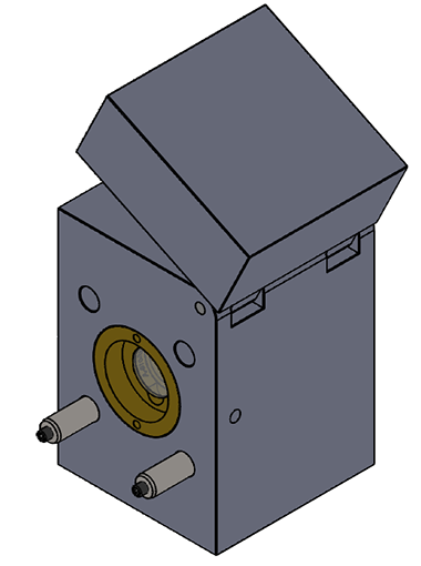

Step 2: Fix the rods
Mount the two ER1 rods such that they are flush with the CP33/M mount. Then, place two drops of epoxy glue in the rods hole and insert the rods/CP33 assembly using the spacer block to provide the correct entry depth.

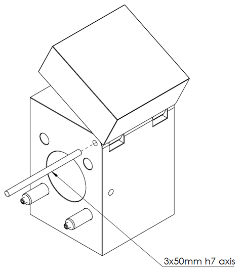

Step 3: Add cover
Add the cover and secure it with the axis. Eventually add a drop of axis locker glue such as Loctite 638. Wipe off the excess glue.

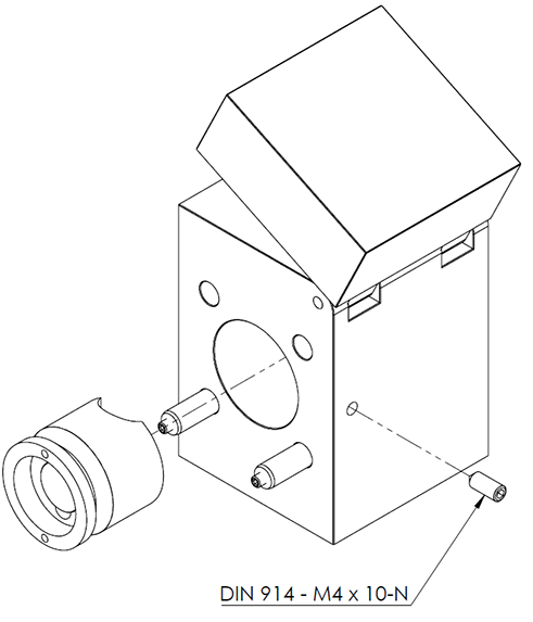

Step 4: Add the optical barrel
Add the optical barrel in place and secure it with a DIN914 set screw. Align the two holes of the barrel such that they are vertical relative to the cuvette holder body.
