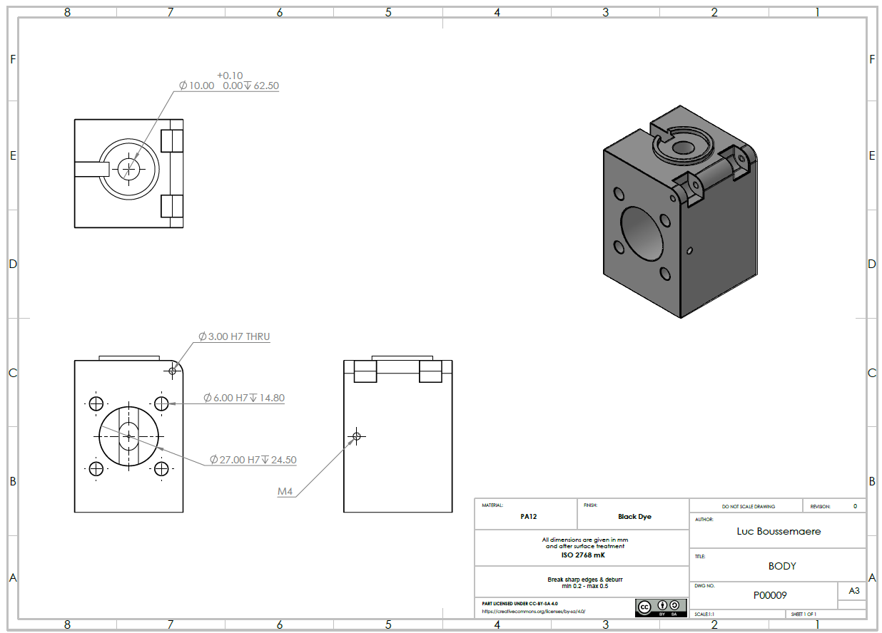

3D prints are usualy provided with loose tolerances and no threads. You must read the joined PDF of each parts to know which features need to be post-processed.
As an illustration, Figure 1 shows a 3D print with multiple toleranced features:
- The top hole must be no less than ⌀10.0 mm and no more than ⌀10.1 mm diameter. This can usually be achieved by using a standard drill bit of 10.0 mm and passing the drill bit multiple times into the hole.
- Multiple holes on the front face need H7 tolerance. This is usually performed using precision reamers which are available in standardized sizes (⌀3 mm, ⌀6 mm etc.). Larger holes, like the one of ⌀27 mm need to be machined using a CNC milling machine. In all cases, you can consult the assembly PDF to check which parts interract with the feature. Here, the ⌀27 mm hole should accept an optical barrel with minimal gap between the two parts - the CNC milling job can then be adjusted in consequence.
- A M4 thread needs to be tapped on the side of the part.
Figure 1 - Example of toleranced features on a 3D print
