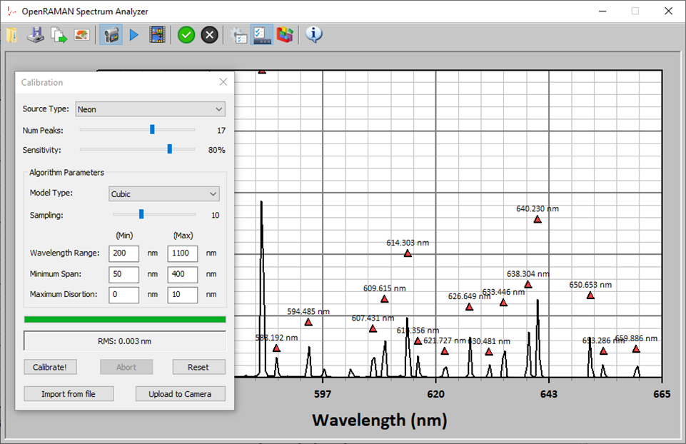

Once you have acquired a clean spectrum, open the calibration window by clicking the button in the toolbar. Adjust the number of peaks and sensitivity such that the software correctly identifies your peaks. Note that the software is robust to missing peaks but does not tolerate erroneous peak.
Next, set the algorithm parameters and click the “Calibrate!” button. The quality of the fit will be shown in terms of a RMS figure. A RMS much below the resolution of the spectrometer indicate a good fit quality. When you are confident in the quality of the fit, you can upload the calibration data to the camera.
The algorithm that was developed to calibrate the system is relatively robust but may need some tweaking. You can either choose from a Linear model or from a Cubic model. Cubic model offers more flexibility but is slower to fit. If the algorithm does not fit properly, you can try increasing the sampling parameter. Increased sampling will run slower.
The algorithm works by a global search method that will reject solutions that are outside boundaries. You can define boundaries for the following parameters:
Wavelength range of the spectrometer. By default, the algorithm will cover all the visible range of silicium detectors plus some margin. If the algorithm fails to converge, you can narrow these fields towards the theoretical value of your spectrometer design.
Minimum Span is how much wavelength your camera sensor will cover. By default, the software will cover a relatively large span.
Maximum distortion will limit the deviations to the linear model. This mode is available only in cubic model type. It is recommended to leave the minimum value at zero.
When tweaking these values, always use some safety margins. For example, if you spectrometer has a theoretical range of 550-670 nm, use values such as 520-700 nm or even more.
