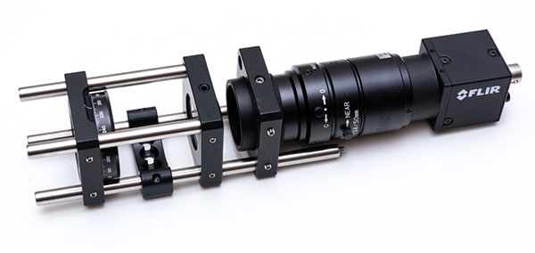

Step 2 — Aligning the Slit
We will now align the slit in regards to the lens using the camera lens:
Step 2: Slit Alignment
Add two temporary ER2 2″ rods on the side of the lens. Connect the camera to the machine vision lens. Set the lens to the infinite (FAR direction), fully-open (O) positions and tighten the adjustment screws to lock the settings. Connect the SM1A36 adapter and the SM1L05 extension tube to the lens. Add a CP36 cage to the lenses group and insert the machine vision lens as shown on the figure. Tighten the CP36 cage.
Now connect the camera to your computer and run the acquisition software. Set the frame rate to 10 fps, gain to zero and increase the exposure time until you see a signal on your monitor. You may have to orient the assembly towards a light source to see something but a daylight lit room should normally be enough. Image of the slit will most probably be out of focus and slanted. Orientation of the slit is not an issue at this stage. Slide the CRM1/M cage on the rods until the image is perfectly sharp on your monitor. Eventually zoom-in to see the details of the edge. Once in-focus, tighten all the screws of the CRM1/M cage. You may have to practice a little bit in keeping the focus while tightening the screws.
Here you basically aligned the slit at the focal position of the first lens using the machine vision lens as a reference to infinity. Ideally, one would use an autocollimator to do that but these are pretty expensive pieces of equipment and are not really mandatory in this case. By the way, there is a rule in optics which says that once you have aligned something, you should never touch at the set screws anymore. This part is aligned and you should not touch it again; if you have to untighten the screws at some point it means that you fucked up your alignment procedure somewhere! Here the alignment is relatively easy but sometimes you have to be clever and insert temporary mirrors and such.

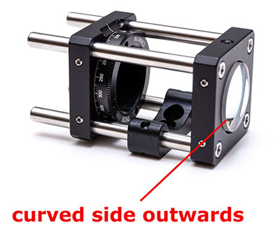

Step 3 — Second Lens
We will now align the second lens:
Step 3: Second Lens
Place the AC127-019-A achromat lens into the CP14/M cage plate and insert the plate at the back of the slit with the most curved part oriented outwards. Remove the temporary alignment system and place it behind the other side of the setup. Align the lens the same way as you just did previously.
Note that the image of the slit will appear larger because the lens is 19 mm focal length this time and was 50 mm focal length previously so you have a 5:2 magnification factor from the previous configuration. This is the basic of how a microscope works.

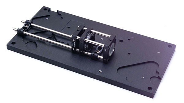

Step 4 — Baseplate
Step 4: Baseplate

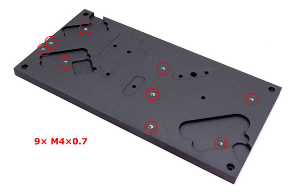

The baseplate accepts all the components of the system and places them in the right position, both laterally and vertically. As some of the cage plates and brackets have varying dimensions, some must be placed lower than others. This is why the baseplate is machined as it is.
Some of the holes of the baseplate should also be tapped with M4×0.7 holes. If you ordered the baseplate from 3D printing, you will have to tap the holes yourself. I recommend using helicoils steel inserts for this purpose. Check the tooling page for recommendation on helicoils placement.

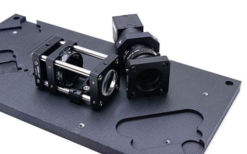

We will now place the lenses group and the cuvette holder bracket on the base plate:
Step 4: Baseplate
Use temporary ER6 rods to align the axis of the bracket and the lenses group. Secure the ER02B brackets using M4×6 screws and the CRM1/M using a M4×12 screw from below the baseplate. Remove the temporary rods once all the screws have been placed.

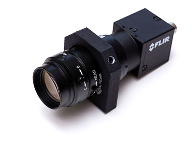

Step 5 — Camera
We will now add the camera to the baseplate.
First detach the machine vision lens from the camera. Insert the camera holder bracket from the rear and reconnect the camera asap. Pay attention that no dust enters the assembly. If you notice dust, flush them with gentle compressed air.

Step 5: Camera
Three of the holes of the camera bracket are designed to hold nylon-tipped set screws and two other holes are designed to fasten the bracket to the base plate. You should tap all these holes to M4×0.7 if you ordered the part in 3D printing but only the holes designed to fasten the bracket to the base plate should have helicoils. The three other holes will have low stress as they are only use to prevent the machine vision lens from moving.
Add the machine vision lens to the baseplate using two M4×12 screws from below but do not tighten them yet:

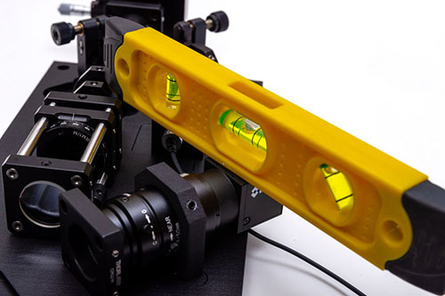

Use a temporary CP02/M cage plate to set the camera along the correct axis. You should be able to move the camera from left to right gently as well as back and worth until you see that it fits tight against the CP02/M cage plate. Tighten the camera holder bracket but leave the nylon-tipped set screws untightened at this stage.
Use a carpenter level to set the proper orientation of the camera and tighten gently the nylon-tipped set screws (check that your table is horizontal before!).
Step 5: Camera
The idea of this part of the assembly is to orient the sensor horizontal with the base plate. Here we used the housing of the camera as a reference. In my experience, camera sensors are relatively well aligned to the housing so this is good enough for what we have to do. Remove the temporary cage plate.

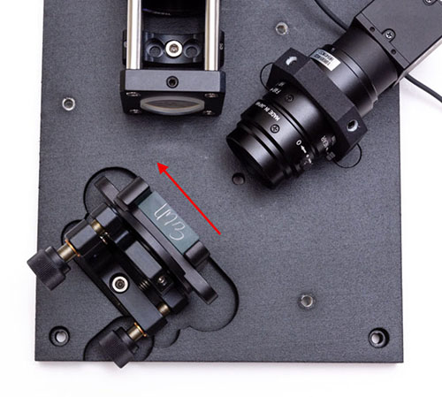

Step 6 — Grating

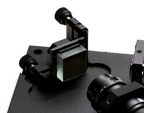

Now place the grating in the KGM40 bracket and the KM100 kinematic plate. Fix the kinematic base to the base plate using a M4×10 screw.
You will notice that Thorlabs gratings have an arrow drawn on their side. This arrow should be oriented away from the camera as shown here:

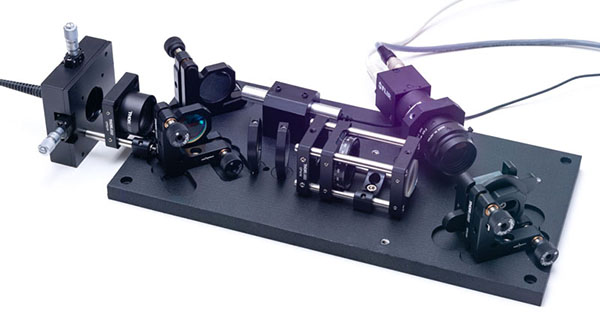

Step 7 — Other Components
We can now add all the other components on the baseplate:
Step 7: Laser and Mirrors
Put the laser in its holder. Again, if you 3D printed the holder, only the holes designed to fasten the holder to the baseplate should have helicoils. The two holes on the top can have normal M4×0.7 taps as they receive nylon-tipped screws. Tighten the laser using two nylon-tipped screws at roughly the position shown in the image. Place the laser holder on the baseplate using two M4×12 screws.
Add the steering mirror and the dichroic mirror using two KM100 kinematic plates using two M4×10 screws. Pay attention to the orientation of the dichroic mirror, the shiny surface should face the incoming beam.
Add the FELH0550 edge filter and the WG11050-A compensation window in their FMP1/M mount using two M4×12 screws from below. Pay attention to the side of the edge filter as the arrow drawn on the housing should face the lenses group. Orient the elements as shown on the image.

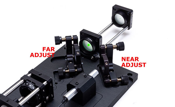

Step 8 — Beam Steering
Add two ER6 extension rods with the two DG10-1500-H1-MD ground glass alignment disks mounted in CP02/M cage plates as shown on the image. We will use these ground glass disks to align the laser beam with the optical axis of the system:
Step 8: Beam Steering
The idea is to center the laser beam in both holes of the ground glass disks.
Once the laser has been turned on, you can adjust the near side interception with the steering mirror and the far side adjustment using the dichroic mirror. This is an iterative procedure because moving the far adjustment will slightly affect the near side as well, but only by a small amount due to the leverage.
Once the laser is correctly steered, you can remove the temporary rods and ground glass disks.

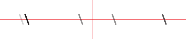

Put the other end of the fiber next to a fluorescent lamp and start the camera software. Adjust the exposure settings so that the image does not saturate. Turn the crosshair mode on in the acquisition software to aid the alignment.
You should see something looking like this (schematized):

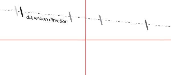

First rotate the grating using the KGM40 plate until the dispersion direction is aligned with the crosshair. You will eventually have to tune the signal vertically using the kinematic plate knobs. Once aligned, tighten the screw of the kinematic plate to hold the KGM40 plate in place.
You should see something like this (schematized):

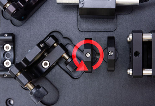

We will now orient the slit such that it is vertical. Turn the CRM1/M plate until the slit is perfectly vertical and tighten the set screw on the side (next to the camera).
