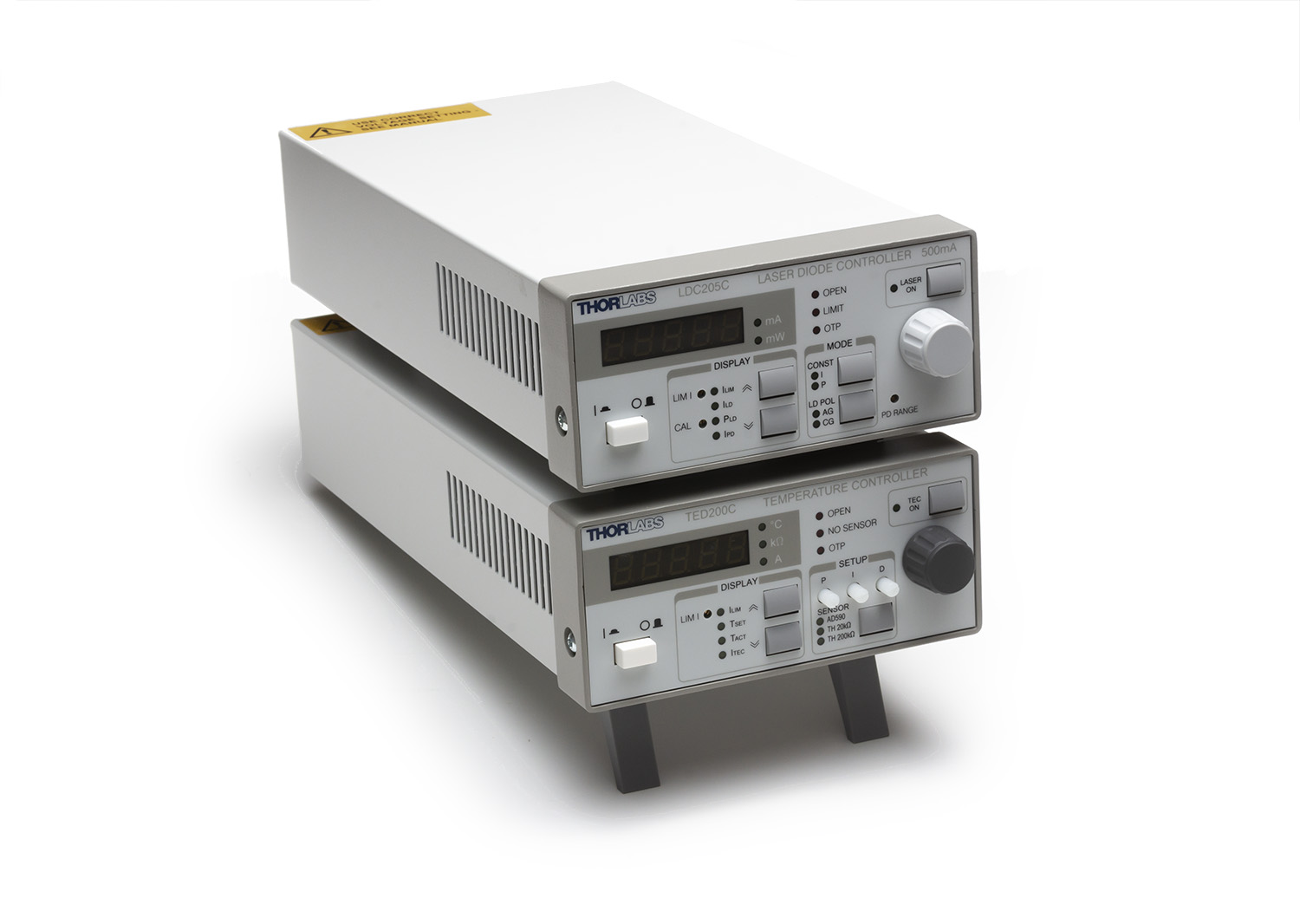

Thorlabs LDC205C & TED200C Driver
Thorlabs proposes both the LDC205C and the TED200C drivers as dedicated laboratory units, as shown in Figure 1.
Thorlabs LD & TEC Drivers
Credits: https://www.thorlabs.com
All the following instructions refer to the Thorlabs drivers LDC205C and TED200C. These drivers can be purchased either as part of the LTC56A/M kit or separately. When purchasing the drivers separately, you will also need a CAB400 cable and a CAB420-15. The cables CAB400 and CAB420-15 are however too rigid to be set in place directly in the setup. You will have to make an extension to those cables like in the picture on top of this page.
