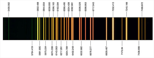

During the alignment process, a calibration of the wavelength axis of the spectrometer is required. Due to the wavelength range used in Raman spectrometers (typ. 550-700 nm), good candidates are neon calibration sources which produce the spectrum of Figure 1.
Figure 1 - Neon Spectrum (credit: Astrosurf)

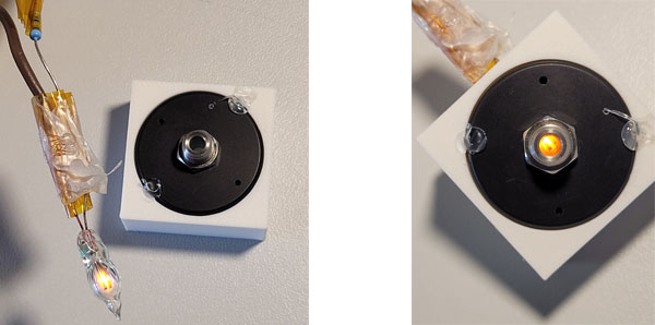

These lamps works straight out of the box with the recommended 600 µm fibers but they are relatively expensive. To help those who are looking for more affordable alternatives, we propose the non-stabilized neon lamp of Figure 2. We used it successfuly in routine operations for non-critical work.
Figure 2 - Low-cost neon calibration source
The system of Figure 2 is directly connected to the main supply (110-220V) through a resistor. The value of the resistor should be matched to the current rating of your specific neon bulb used with some margin. Insulate the system to your best efforts to avoid shorts. In Figure 2, we used Kapton tape as insulator and hot glue to maintain the neon bulb in place.
